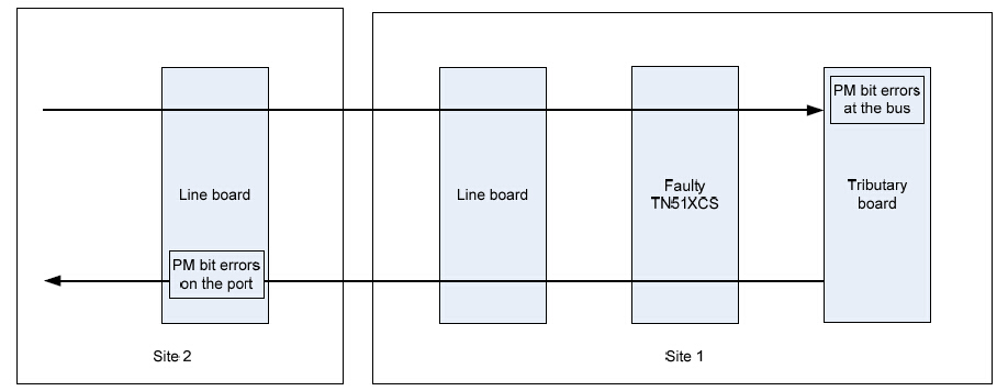

Symptom:
1. Concurrent symptoms on the tributary board:
− According to the query of the current performance events, there is bit error second (BES) or background block error ratio (BBER) in the ODUk PM section. In addition, BES and BBER increase, as indicated by multiple queries. When the performance deteriorates, a BUS_ERR alarm is reported.
− According to the query of the performance events on the line board that is interconnected with the tributary board (under the condition that the non-intrusive monitoring in the ODUk PM section of the corresponding channel is enabled), there is no BES or BBER in the section.
2. Symptoms on line boards:
According to the query of the current performance of the line board at downstream site 2 (under the condition that the non-intrusive monitoring in the ODUk PM section of the corresponding channel is enabled), there is BES or BBER in the section and they increase as indicated by multiple queries; however, there is no BES or BBER in the OTUk section on the line board. When the performance deteriorates, a BUS_ERR alarm is reported on the line board that is directly interconnected with the cross-connect board.
site1 site 2
