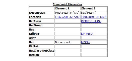

Constraints:
Constraints are enabled:
But some other constraint seems to be active:
The pink color is the hole and the kind of shaded part in the middle is the pad, which will be removed by the drill. So it's a NPTH.
Any ideas why I can route as close as 0.15 mm to the hole and not 0.3 mm?

    Where are the Constraints applied? Use Check (Display)>Constraints, check that all of the elements are on in Find, window select the hole and trace to see the applied Constraints.

    17.2 ? Have a look to constraint mode and mechanical section: here is located a check box to use spacing constraint set values instead of provided values in  this section.

    Fredda over 6 years ago
    The Resolved Spacing Constraints list is quite long. See below.
    I'm using Allegro 17.2.
    Which part are you referring to? In the Design for Fabrication part, there are a number of copper spacing constraints. How do they differ from the spacing constraints? I must be missing something here...
    By the way, the Hole to Line spacing constraint works on the top layer, but not on the bottom and the internal layers.

    I posted a reply, but it was flagged as spam. Probably because of a long list of resolved constraints after using Display->Constraints. Don't know if it will pop up here later.
    In any case, I just found out that, as jc teyssier pointed out, there was a checkbox in the Design part in the Analysis Mode dialog window that needed to be ticked.
    These constraints settings are not that easy to understand... While I'm at it, what is the difference between the Spacing constraints and the Design for Fabrication->Copper Spacing constraints? They seem to control the same things.
