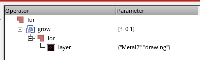

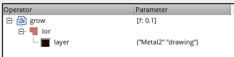

    The split is because the grow operator is still splitting with the default number of vertices (I'll raise this too with the team). This can be fixed by changing the geo expression from:
    To:
    In other words, another lor around the grow.
