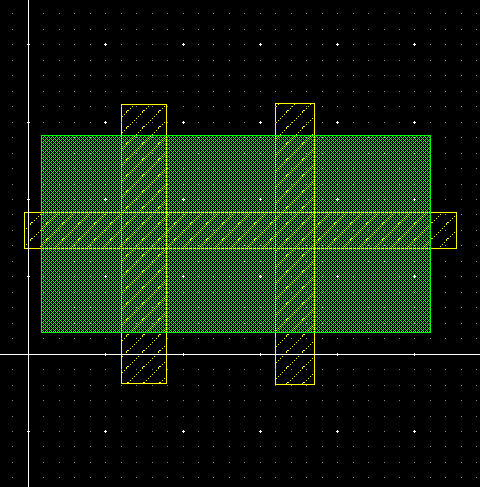

I've found myself wanting to split shapes into multiple shapes many times. What is the best way to split a rectangle into multiple pieces along lines/or edges that bisects the shape?
The geo->tile command doesn't work on a rectangle.
The geo->bisect command only gives you half the shape and you can't specify the split line.
Any use of land or lor merges any abutting shapes I've already split.
I even looked into dropping into skill to try to use leSplitShape, but that doesn't really create multiple shapes.
Ideally, I'd have one command that takes a named shape (which can contain multiple rectangles or polygons) and a named shape consisting of edges that may or may not bisect the shapes, and return all the shapes, where those shapes which are bisected by the edges are split into multiple shapes along the edges.
Think of a big square where I want to make an asymmetrical tic-tac-toe box out of it.
Anyone have a solution that doesn't take half a dozen complex geo commands, a couple of stretch commands, and a bunch of intermediary measurement steps?

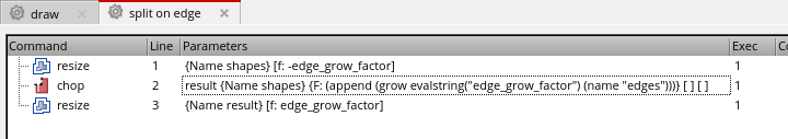

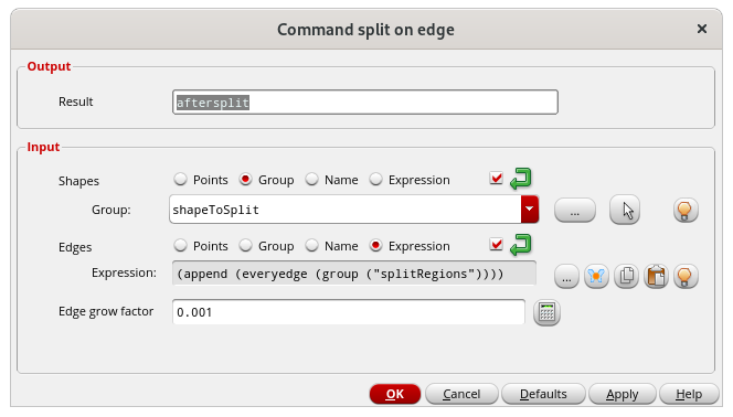

    We don't have (as far as I know) anything direct that does this, but it's not too difficult to achieve with the chop command. The chop command requires a shape (not just an edge), but with a little bit…
    0 Andrew Beckett over 1 year ago
    We don't have (as far as I know) anything direct that does this, but it's not too difficult to achieve with the chop command. The chop command requires a shape (not just an edge), but with a little bit of manipulation this can be achieved. The basic approach I used was:
    1. resize (shrink) the source shape by a small amount (e.g. -0.001)
    2. Chop using everyedge of some shapes to identify the places to split, with these edges grown by 0.001
    3. resize (grow) the results by the same small amount (0.001) to remove the gaps caused by the grown edges
    Attached is a pcd.txt file doing this with a gpdk045-based example. I created a custom command to make it a bit clearer.  Some pictures showing the steps:
    The green (Poly) shape is what is going to be split, and I'm going to use the yellow (Nimp) edges to identify the split points. The custom command I've created "split on edge" has these inputs/outputs:
    Here's the method itself - hopefully from this (without showing the geo query editor) you can see it's just doing a grow on the "edges" input, and the edges input above is using the everyedge operator on the splitRegions group.. The resize commands below are sizing down the input shape and then sizing up the results afterwards.
    This then gives this result:
    Hope that helps! We'll also think whether a more direct (this is not too indirect, though) split command could be added. Note using leSplitShape won't be an option because that's not PCell-safe.
