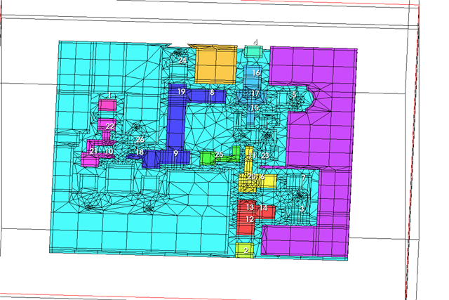

    It looks like the EM simulation alaways excites port 1 on the extraction, but port 1 on the extraction never seems to be port 1 on the schematic. Is this a bug, or is there a way to force the extraction port 1 to be the same as the schematic port 1?
    We tried Analyst to see if it behaves differently.  Here are the current/fields.  You can see Port 1 in the EM at the bottom just above port-12.  The excitation should be at Port 34 in the top-left.

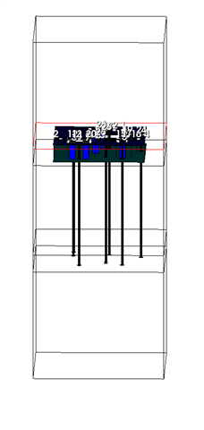

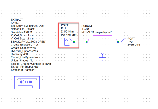

    I was able to get your project to run and I found some issues that need to be addressed. I would also stress trying to get individual pieces to work rather than trying to do it all in one shot. I would start with a simple two layer stackup, get extraction to work and any other advanced features individually, and then start adding complexity by adding the advanced features together.
    1. Look at the 3D view for the EM Structure of your LNA design. It looks like the scaling is off. I was able to fix this by going into the substrate information and modifying the scaling. This issue is shown in Figure 1.
    2. There is some floating copper (not connected to ground) in the extracted 3D view. I provided a picture where teal is the ground color and the floating copper is in purple and orange. This issue is shown in Figure 2.
    3. On the LNA schematic page, you need a HB port excitation. This issue is shown in Figure 3. Note that you need to set an appropriate input power level based on the device datasheet to get the desired results.
