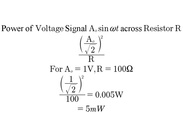

    1. The testcase with a sinusoidal voltage (1V peak) across a 100 Ohm resistor gives hb = 5mW. Pout = V^2/R = 1^2/100 = 10mW. I have to think about where the x2 comes from, but I agree with you hb is giving MAXIMUM, not rms values.
    Please check your calculation, as I think the power of a 1 V amplitude sinusoid (2 Vpp) across a 100 ohm resistor is:
