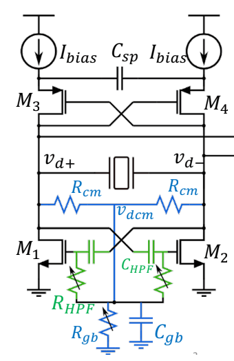

Hello everyone,
I'm currently working on the design of a cross-coupled oscillator, based on the circuit architecture shown in the attached figure (from a referenced paper). The resonator has a center frequency of 2.49 GHz, with C0 = 0.98 pF.
One of the key challenges I’m facing is ringing, which appears to be caused by the negative capacitance effects introduced by Csp and CHPF. In order to suppress this ringing, I attempted to ensure that the loop gain is less than 1 at the ringing frequency. However, this makes it difficult to simultaneously satisfy both of the following conditions:
  • Loop gain > 1 at 2.49 GHz
  • Loop gain < 1 at the ringing frequency
Simulation Setup:
  1. For loop gain analysis, I used the STB (stability) analysis with an iprobe placed at the gate of M2.
  2. For analyzing negative impedance and capacitance, I ran AC simulations by placing a current source across the output nodes and calculating the real and imaginary parts of the resulting impedance.
I would appreciate any suggestions or insights on simulation techniques and design strategies that could help with this issue.
