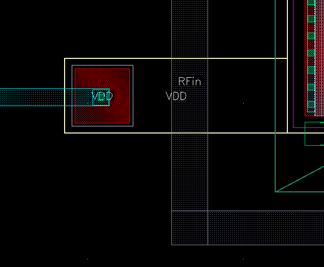

Hello everybody,
In order to use  "P+ diffusion resistor with salicide (3 terminal)" in my design, how can I connect the Bulk (N-Well) to VDD (metal 8)?

    Andrew Beckett 11 months ago
    You didn't mention which PDK this was but presumably you'd need to create an N Well contact and then a stack of vias up to Metal 8. That seems fairly obvious, but maybe I'm missing something here?

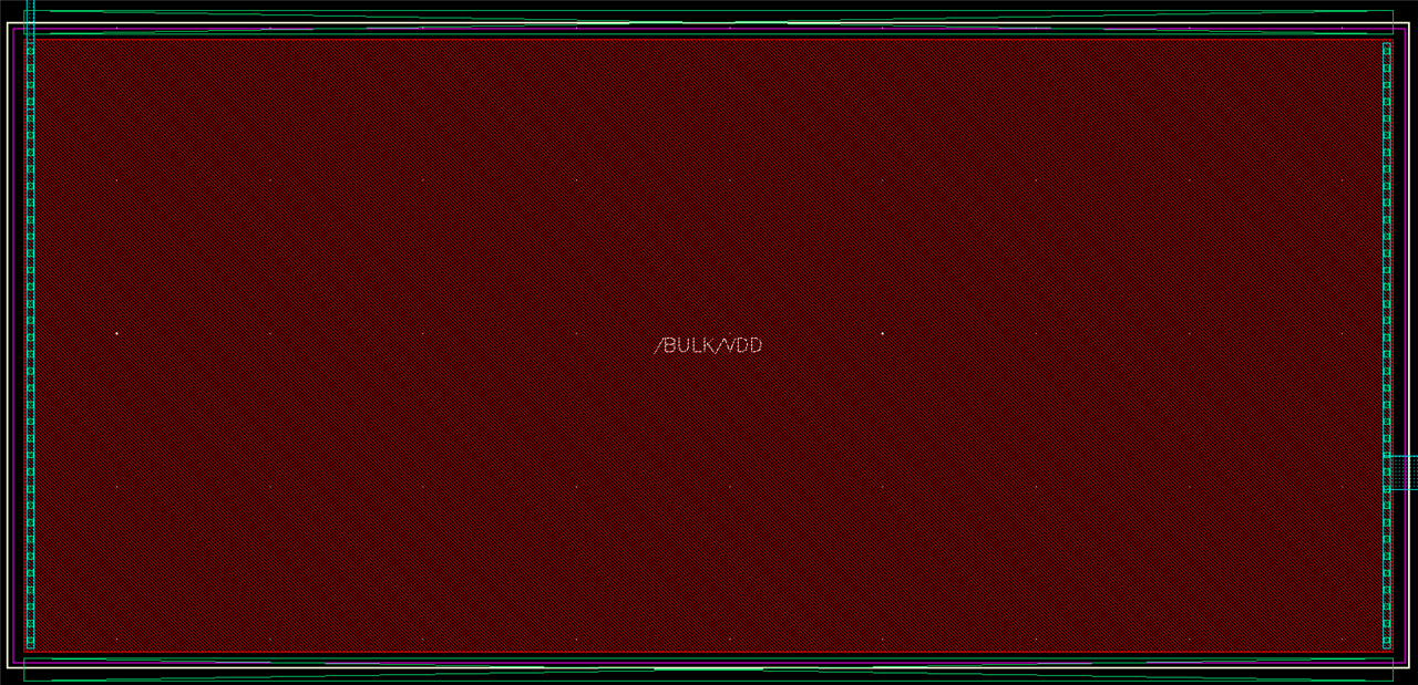

    SamanMKD 11 months ago in reply to Andrew Beckett
    Dear Andrew,
    Thanks for your reply. I am using 28nm HPCP PDK. I created a N-WELL contact as you mentioned and it fixed the connectivity issue and DRC errors.
