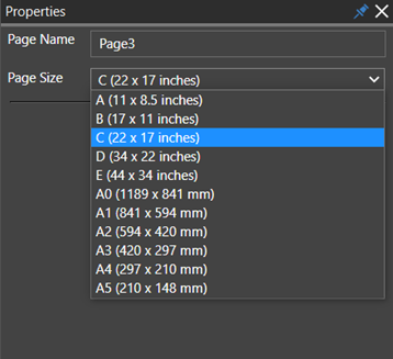

This can happen because of page border size. The page border size determines the extent of the LiveDoc canvas. If the view extends beyond the LiveDoc canvas, you might not place a PCB view when changing its scaling or rotating it.
You can either replace the default page size with a page with a larger size or reduce the scaling in the Properties panel. You can also set the new page size as the default for creating new pages.
