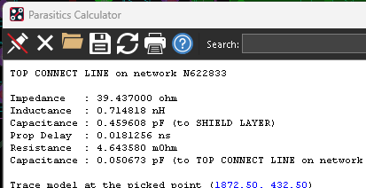

    Currently we can show parasitics in Orcad and Allegro X by typing the command "show parasitics" in the command prompt. Now the user can select each cline they wish in succession. This calculator display appears to the user and will recalculate depending on the cline selection.
    Currently this functionality is not yet available in the Presto PCB Editor. .
