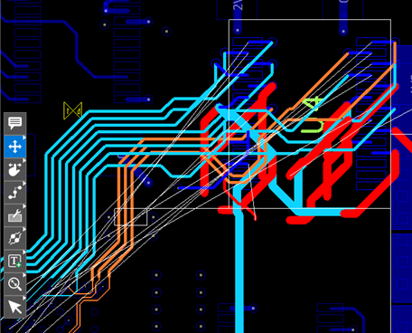

  2. Select the part on the board. The part shows the associated clines.

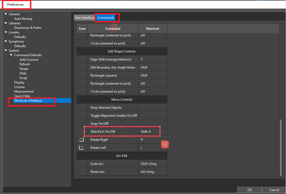

  3. While still selecting the part, press Shift+E simultaneously.
  4. The part will no longer show the clines.
  5. You can now place it at the desired location.

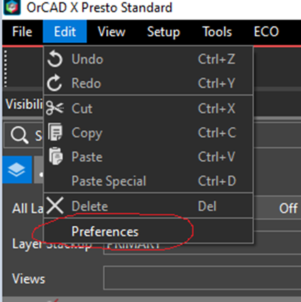

To check the shortcut, select Edit > Preferences > Shortcuts (Hotkeys) and select the Commands tab.
