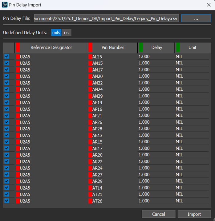

Starting with SPB 25.1, OrCAD X Presto lets you import pin delay values in bulk using a .txt or .csv file.
How to Use?
  1. Go to File > Import > Pin Delay in Presto
  2. Select your pin delay file (.txt or .csv)
  3. Review and adjust values in the import form (sample image below)
The Pin Delay Import form validates REFDES and PIN combinations, highlights mismatches, and lets you skip rows if needed.
  1. Once done, Click Import .

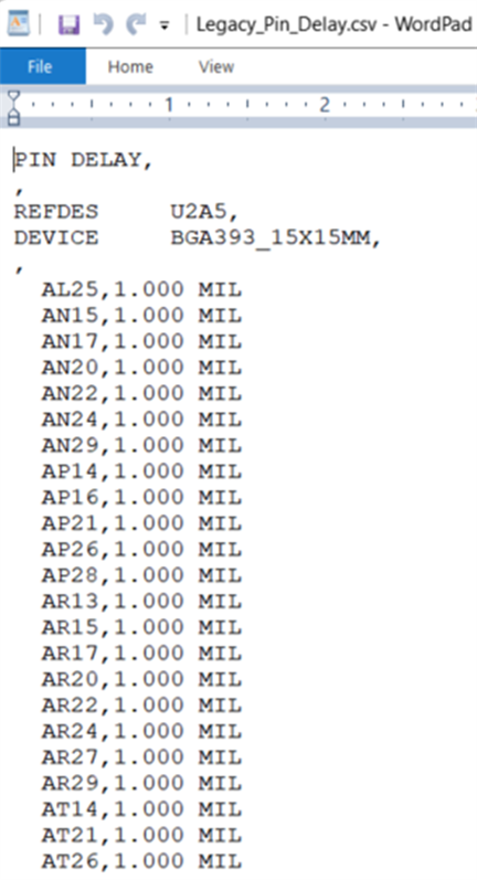

Your Pin delay file should contain Pin delay data for one component instance:
Here is a sample pindelay file:
