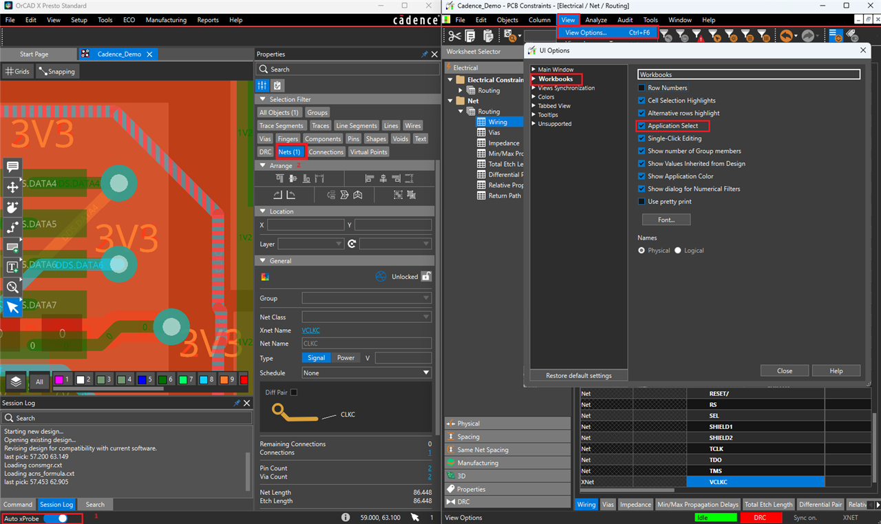

If you're working with OrCAD X Presto and want to cross-probe between the canvas and Constraint Manager, here's a step-by-step guide to help you achieve this:
Step 1: Enable Auto xProbe in OrCAD X Presto Canvas
Open your OrCAD X Presto canvas and enable the Auto xProbe option at the bottom left of the canvas.
Step 2: Enable Application Select in Constraint Manager
Open Constraint Manager, go to View, then View Options, and Workbooks, and enable the Application Select option, then close the form.
Step 3: Cross-Probe Between OrCAD X Presto Canvas and Constraint Manager
Once both options are enabled, you can now cross-probe between the OrCAD X Presto canvas and Constraint Manager window. Ensure that Nets in Selection Filter is enabled to highlight the net between the two windows.
By following these simple steps, you can easily cross-probe between the OrCAD X Presto canvas and Constraint Manager. If you have any questions or need further assistance, feel free to ask!
