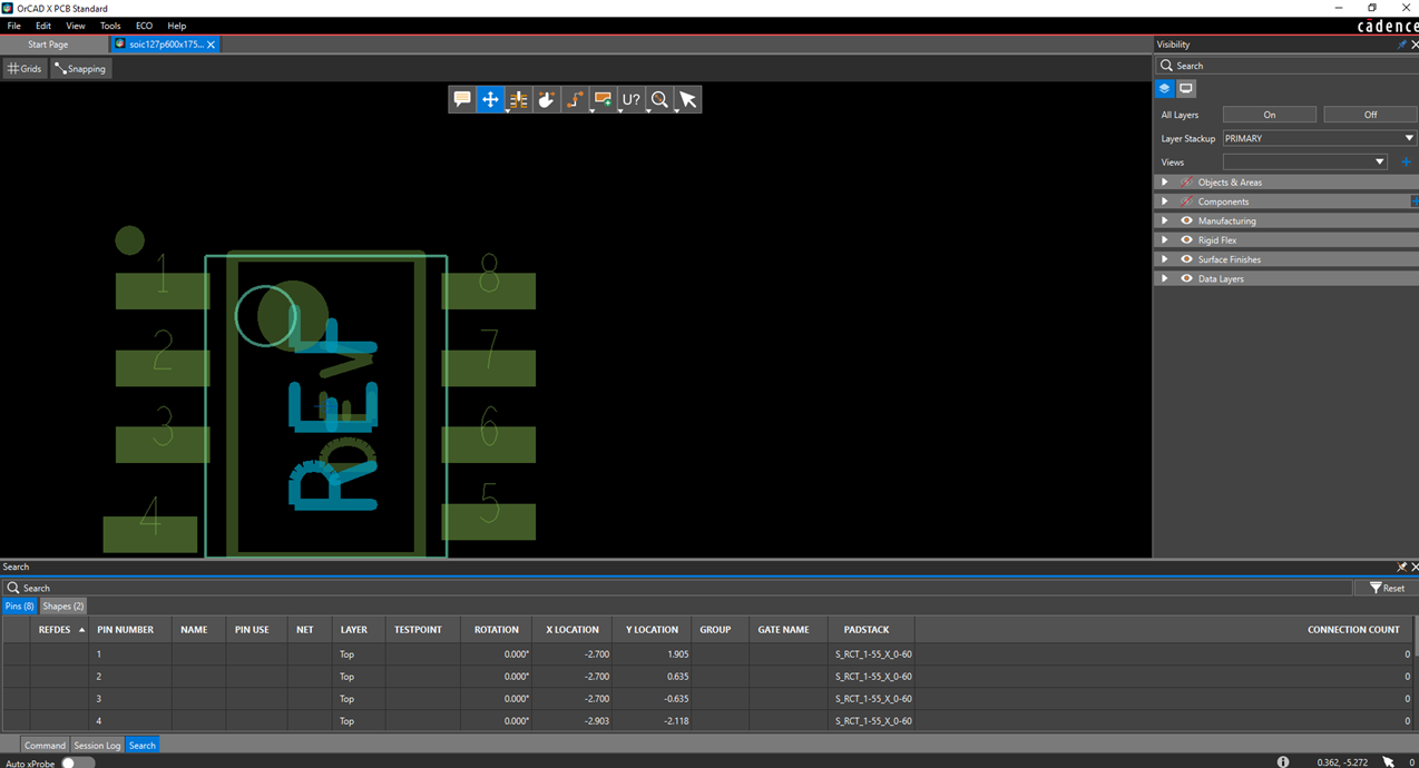

In OrCAD X Presto, you can now edit pin locations quickly using the spreadsheet in the Search tab.
In the screenshot below, observe that pin 4 of the footprint is not aligned with the other pins.
You can easily notice the misalignment in the Search tab. As shown in the screenshot above, pin 4 is currently located at (-2.903, -2.118). Since the pins are aligned vertically, its x-coordinate should be -2.700.

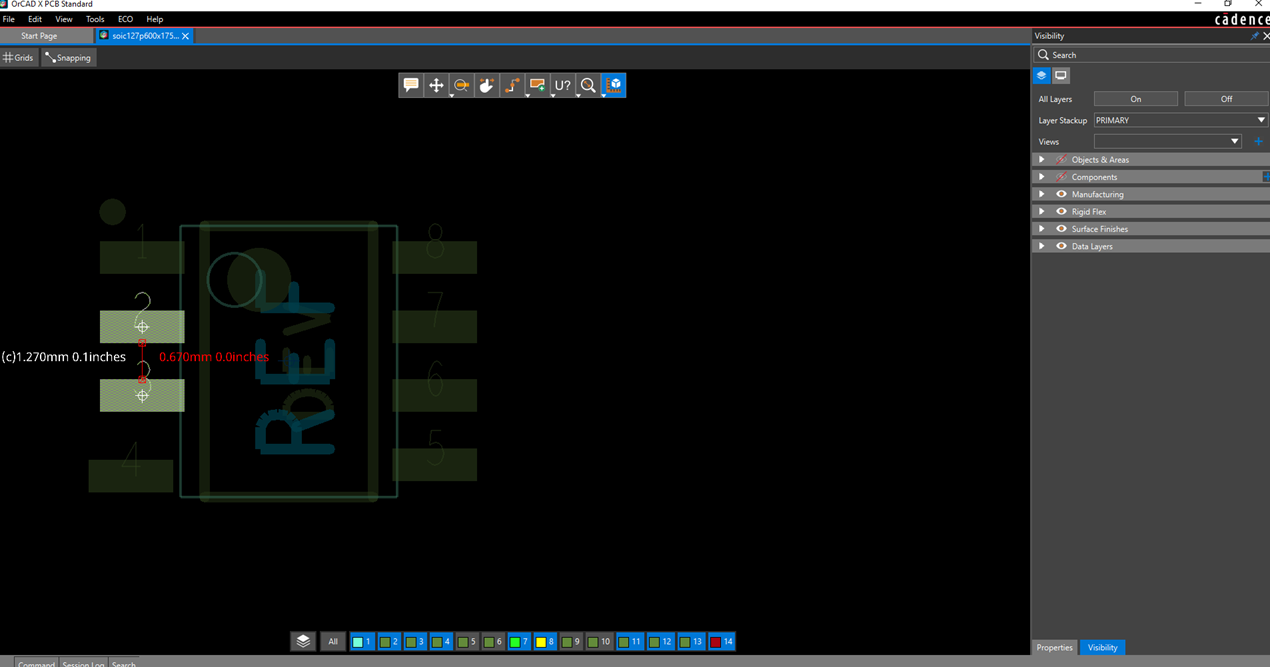

As shown below, the distance between pins is 1.270 mm, and pin 3 is located at (-2.700, -0.635).

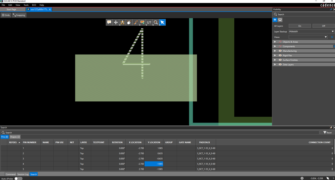

Therefore, the correct location for pin 4 should be (-2.700, -1.905). This can be easily edited using the Search tab, as demonstrated in the screenshot below.
