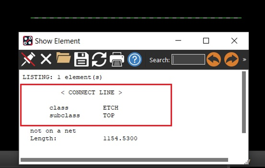

Routed traces or clines are represented differently in APD+ and Allegro PCB Editor. In APD+, they are represented as CONDUCTOR elements, while in Allegro PCB Editor, they are represented as ETCH elements.

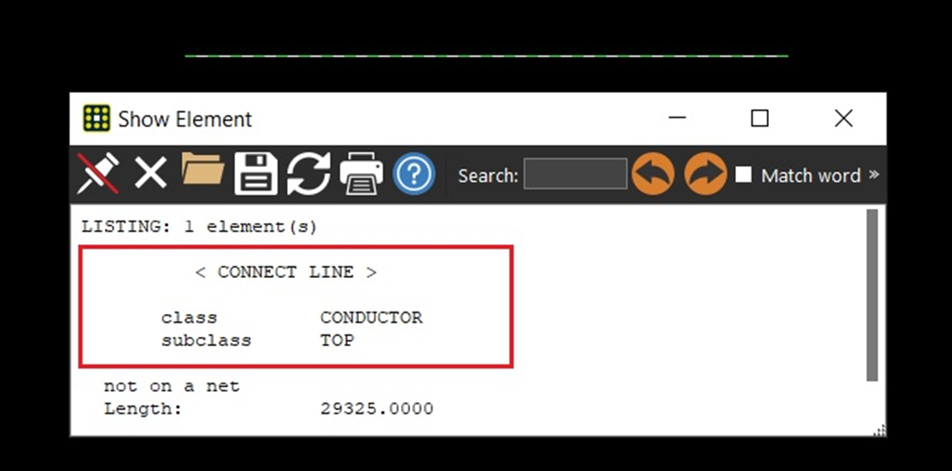

1. Open a mcm file in APD+ and check the representation of cline by using Display > Element.

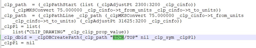

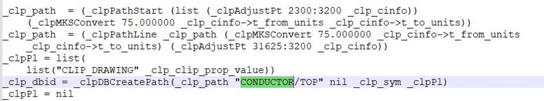

2. Go to File > Export > Sub-Drawing and export this cline from the database. Notice that it is represented as CONDUCTOR in the subdrawing clp file.
3.Replace and change the CONDUCTOR in the clp file to ETCH as follows
4.Open the brd file in Allegro PCB Editor and go to File > Import > Sub-Drawing to import this clp file. This will import the routed trace or cline from the APD+ database to the Allegro PCB Editor database.
Note: Make sure you have the same netlist information in both databases to ensure correct connectivity.
You can also use this procedure to import a cline from Allegro PCB Editor to APD+. Simply replace the ETCH element with the CONDUCTOR element in the clip file before importing it into the APD+ database.
