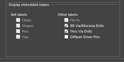

why is display options in setup greyed out for some of the items

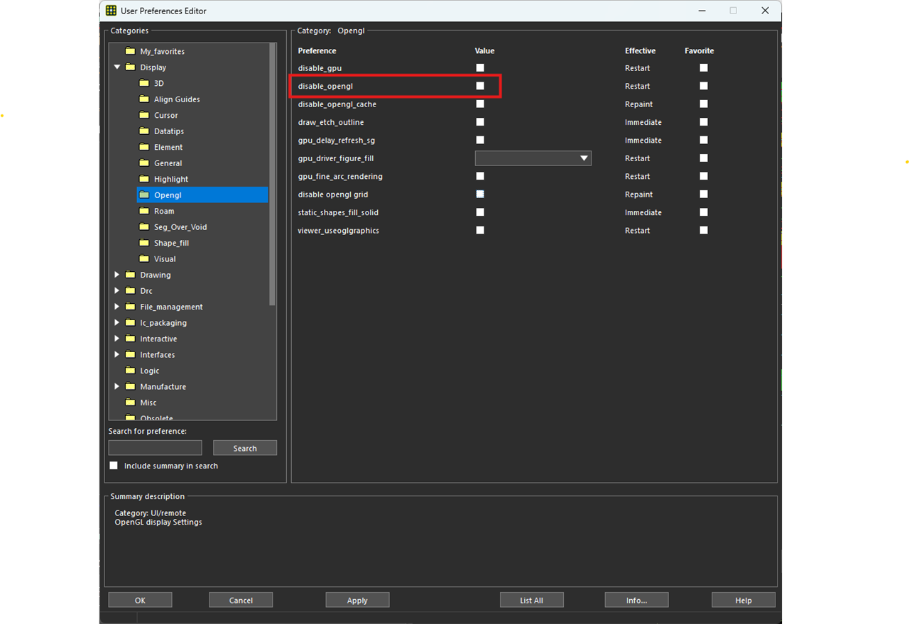

    Hello am4590 , Seems like opengl is disabled. Go to Setup>User Prefernces>Display>OpenGL>disable_openGL, Uncheck this Variable if it is checked, restart the tool. After doing this check now, if you are…

    Hello am4590, Seems like opengl is disabled. Go to Setup>User Prefernces>Display>OpenGL>disable_openGL, Uncheck this Variable if it is checked, restart the tool.
    After doing this check now, if you are able to select the display options
