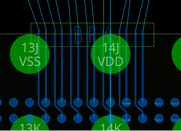

Step #1: Generate the die escape routing in Allegro X Advanced Package Designer
You can generate die escape routes using Route > Flip Chip Die Escape Generator.

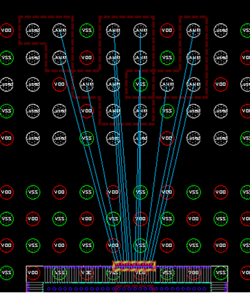

Although the connections were optimized prior to die escape generation, rastnets are observed crossing on the northeast side of the breakout routing, indicating potential inefficiencies in the layout.

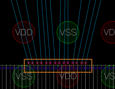

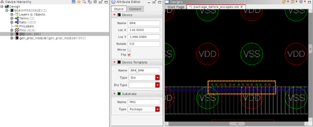

Step #2: Creating a new component in Allegro X Advanced Package Designer

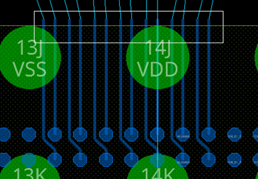

After loading a Skill context file containing custom code, a new command becomes available: brk comp create.
Upon executing the command, you are prompted to select two points to draw a rectangle around the end of the escape routes and to enter a reference designator name for the new component.
The component is then created with pins representing the endpoints of the escape routes, making it ready for import into Integrity System Planner for further connection optimization.

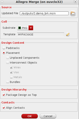

Step #3: Importing the Allegro X Advanced Package Designer database in Integrity System Planner
Thanks to the interoperability of our tools, you can import the Allegro X Advanced Package Designer database into Integrity System Planner in the blink of an eye using the Tools > Merge Updated Allegro command.
The newly created BRK component, along with its associated connectivity, is seamlessly imported into Integrity System Planner, ready for further optimization.

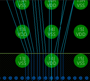

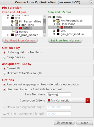

Step #4: Optimizing the connectivity between the escape routing and the BGA balls
In Integrity System Planner, you can optimize connectivity between two sets of pins: one set is fixed, meaning no changes are applied, while the other set remains flexible and can be updated.
By clicking Optimize, the connections are efficiently refined between the endpoints of the escape routes—represented by the BRK component’s pins—and the BGA balls.
