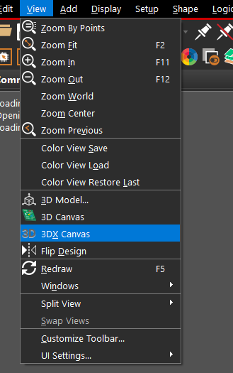

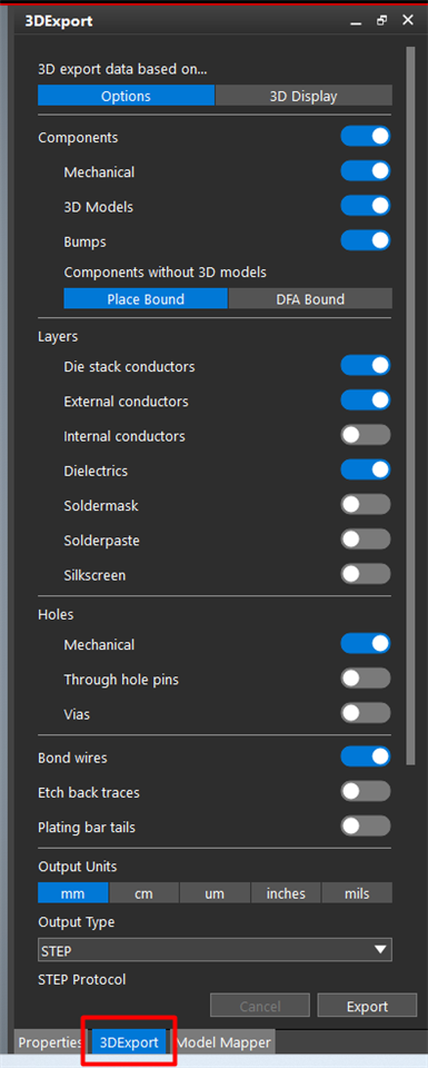

I am using Allegro X APD 24.1. I want to export the design as a STEP file, including all layers, dielectrics and vias. I found that should be possible but I don't see the option:
  • JuanCR
    JuanCR over 1 year ago +1 verified
    Hi! If you open 3DX canvas, you'll find the "3DExport" tab you can use for this. Follow these steps: 1- Go to View > 3DX Canvas 2- You'll find the 3DExport tab on the right side:
