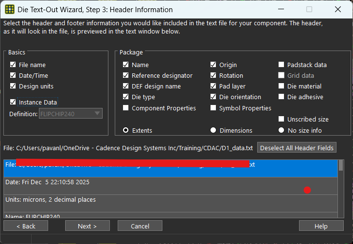

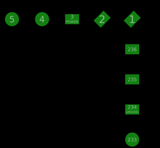

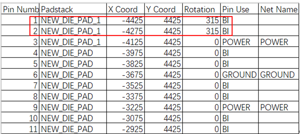

I used group edit to replace a few padstacks (NEW_DIE_PAD) of the die pin with the NEW_DIE_PAD_1 padstack. However, all die padstacks exported during die text-out remain NEW_DIE_PAD, even though die padstacks have already been replaced by NEW_DIE_PAD_1, as shown below. Also, the die pin rotation information cannot be exported during die-text out.

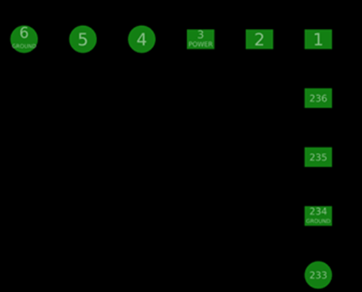

You can select Instance data during die text-out and the updated information of all die pins will be exported, as shown below:
