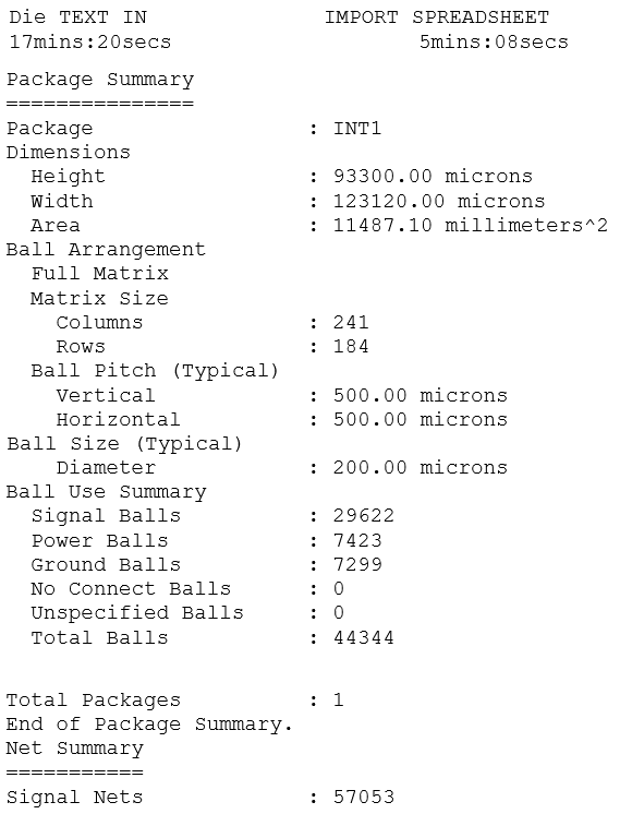

The following Die/Interposer parameters provide processing time metrics for both Die Text-In and Spreadsheet Import for the following design;
The Die/Interposer example above has over 44000 pins and signals.  For this application note, we will use the Die/Interposer based XML spreadsheet option vs. the typical Die Text-In process.

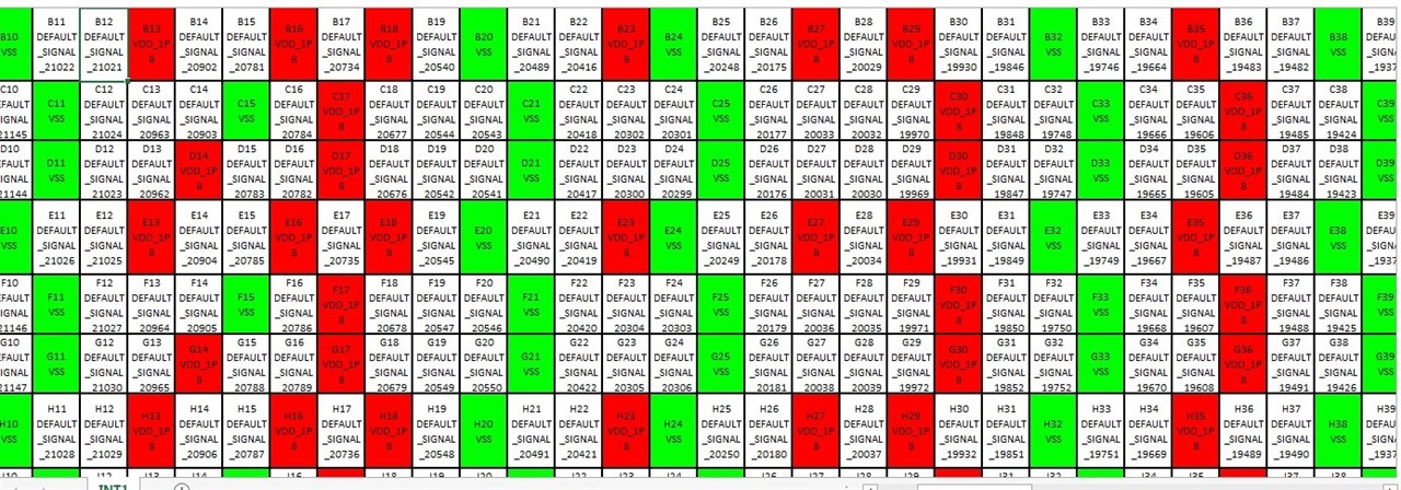

A small section of this large Die is shown below that depicts partial die spreadsheet XML information from the excel spreadsheet below (too large to display the entire view since there are 44000 plus cells!.

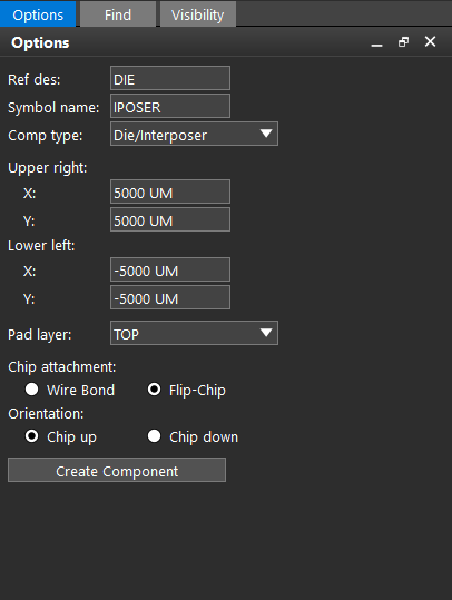

1. Set Allegro X APD Layout to Symbol Editor Application mode and go to Setup > Application > Symbol Edit…
2. In Canvas, RMB > Add Component. For your Die/Interposer xml data, define the information on the Options form for your type of component to be created and all the related information.
3. Enter all associated parameters for your Die/Interposer
4. Alternatively, for your BGA/package carrier xml data, define the information on the Options form for your type of component to be created and all the related information.
Select Create Component at the bottom of the Options form

15. Select Pattern definition and select Spreadsheet from the Pattern style list.
16. In File name, specify the XML file and configure the rest of the fields.Spreadsheet bump/ball array is attached to the cursor.
