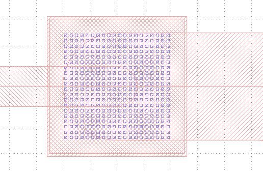

As designs get more involved in WLP designs, there is a need to create IC style via cut arrays in Packaging tools.
I have created IC style via cut arrays in Allegro X Advanced Package Designer. How do I create a GDSII file from it?
For example, take the following cross-section:

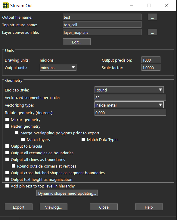

Here are the steps to export GDS file from APD/SiP:
Manufacture > Stream Out
  • Provide GDS file name in the Output file name field.
  • Provide top cell name in the Top structure name field.
  • Browser the cnv file (which has the correct format mentioned above) for Layer conversion file.
  • Click on the Export button.
    Then, you will have GDS with IC style via cut array as shown in the following image:
