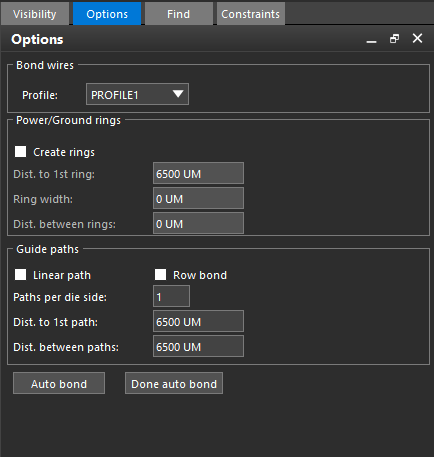

I wanted to ask how someone could auto route or begin the process of auto bonding (I don't know if auto bonding is the same as a traditional auto route) a common bond pad line on some y axis to alternating bond fingers using a single auto bonding command. I just recently learned about the auto bonding command after trying to add guide - lines to the top and bottom bond finger lines and wanted to see if I could speed the process up.
My goal is to be able to auto route these large numbers of pads in a short amount of time and not do them individually as well, so as to avoid any error on my part where they might be on the wrong layer so the simulations are all messed up. The layout is roughly as so:
Top Finger   -   Empty space  -  Top Finger  -  Empty space - ...
Empty space - Bottom Finger - Empty space - Bottom Finger - ...
      Pad -                 Pad -               Pad -                Pad - ....
Where the connects are perfectly orthogonal to the pads and the finger it goes on, all while the pattern between top row and bottom row of fingers is alternating.
Given this information, how would I implement the auto routing function for this?

    Hello, did you try the Auto Bonding Option in APD?
    Steps to Run this.
    1. Run wirebond select command.
    2. Select the Pins
    3. Run pop wirebond auto bond in the command window
