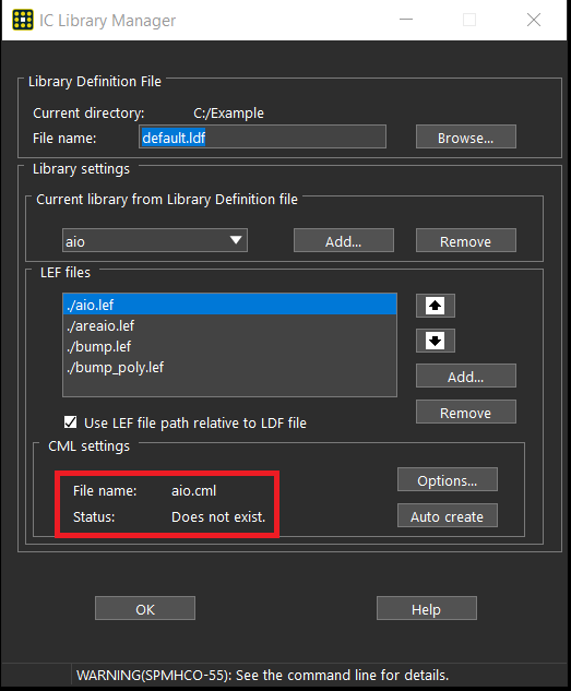

The Setup > LEF Libraries ("lef lib") command is used to specify a set of related LEF library files and to generate the corresponding CML files for each LEF file. Run this command, which brings up the interface as shown below.
First, specify the name and location of the Library Definition File (LDF). Typically, this will be located in the same directory as your LEF library files. If your LEF library files are stored in a central, shared location, consider creating the LDF file in that directory so that the same file can be accessed by all your designers.
Next, define a library name. Once your LDF file name is specified, the Add button for the library will be activated. Click this button and specify the name. The LDF file can contain multiple sets of LEF files, each one representing a different library of LEF files. In this flow, you will define a single library only. Repeat these steps to define additional libraries if you need to.
With the LDF and library specified, it is time to add all the LEF files that are needed for this type of design. The set of LEF files must include the IC technology information in the first LEF file in the list, followed by all the LEF files which define all the macro cell definitions which contain die pads. Add these files one at a time to the list using the Add button. The technology LEF file will automatically be moved to the top of the list when it is added, but it is up to you to order the remaining LEF files to match the order in which they are referenced in the IC design space.
Once you have finished adding and ordering the LEF files for your library, click on the first LEF file in the list and notice that the status of the CML file is listed as "Does not exist", as shown in the previous image. You need to configure the LEF files to guide the system as to which macro pins represent die pads. This process is not as complicated as it sounds, and is mostly a matter of confirming settings.

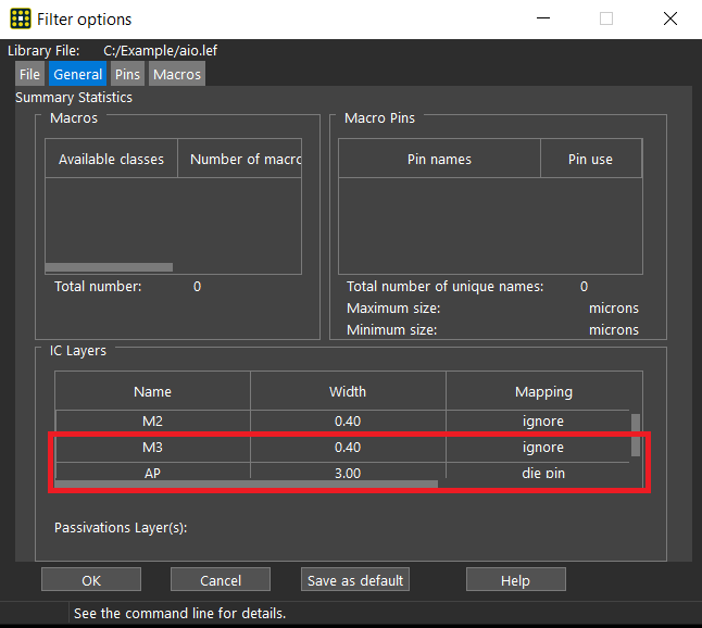

Begin by selecting the LEF technology file, the first file in the list ("aio.lef" in this example) and click the Options button. This opens the form shown below, initially on the General page. Here, you need to identify the IC metal layer on which the die pads are located. Normally, this will be the highest metal layer in the technology information. Select the correct layer in the IC Layers grid and set the mapping to "die pin". Then, close this form by clicking OK and, on the main LEF Library form, click the Auto create button. This will generate a CML file for this LEF file; you will notice that the CML status changes to "Up to date" to reflect this.

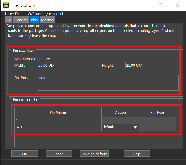

Next, for each remaining LEF file, select the file and click the Options button. On the Pins page, set the minimum die pin width and height fields (You may need to obtain these settings from your IC design team if you do not know what the correct values should be).
When you set the values, the list of pin names that will be considered as die pads automatically populates. If you see a pin name that you know should be globally excluded, change its setting in the grid at the bottom of the form. These fields are highlighted in the image below.
When you are happy with the settings, click OK, return to the main LEF Library command form, and again click the Auto create button. Repeat the process for all remaining LEF files.

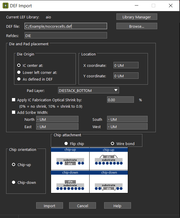

With your cross-section defined, run the Add > Standard Die > DEF (Die Pins Only) ("def in") command. You will be presented with the main DEF Import form as shown below.
To import the design from DEF, first ensure that the correct IC library is active. This is shown at the top of the form. If the wrong library is active, change to the proper one using the Library Manager button to the right of the library name. Then, browse to the DEF file that contains your IC design.
Finally, configure the die type and placement information on the bottom portion of the form. Select the correct chip attachment type and orientation (typically, Wire bond Chip-up or Flip chip Chip-down for mounting on top of the package substrate). If this die will go through an optical shrink during fabrication, ensure you set the shrink and scribe values, as appropriate.
The pad layer and the X/Y location of the die origin are also set on this form. However, you can always move the die after initial creation, if you need to, by using the Edit > Move ("move") or Edit > Die Stack ("diestack editor") command. So, do not worry if you do not know the exact placement details or need to optimize the die positioning to optimize the routing on your package substrate.
Click the Import button when you are satisfied with all the information on the form. The die will be imported into the active drawing. You should verify the results to ensure that all your library settings are correct and that no die pads have been missed (and no internal IC pins have been incorrectly flagged as die pads).

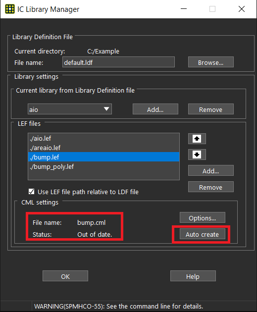

When you receive new versions of LEF library files from your IC design team, you must refresh the CML files for those LEF files. Do this by running the Setup > LEF Libraries ("lef lib") tool. Browse to your library definition file if it is not already active, and select the library containing the LEF files to be refreshed.
For each LEF file which has been modified, the CML status will show "Out of date" as shown in the image below. Click the Auto create button to regenerate the CML file based on the new LEF file’s contents.
Since the CML file stores your settings from the Options page as well as the macro cell definitions, it is not necessary to open the Options tab prior to performing the update. Any customizations you have made will be preserved when the macros are processed and the new CML generated.
