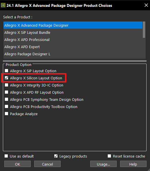

1. This option is only available with Silicon Layout Option as shown below:

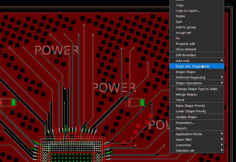

4. Right-click on the shape and choose Erase Adv. Degas Hole.

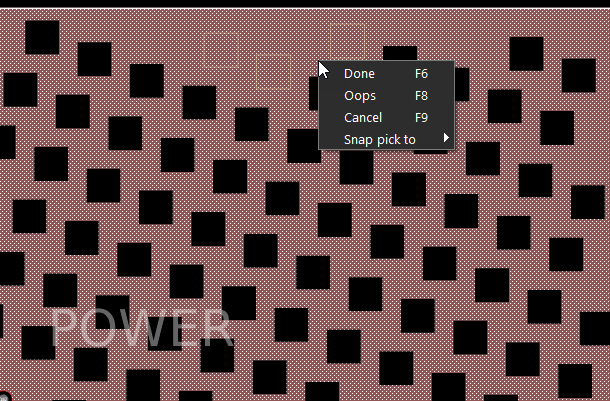

5. Select the voids that you want to delete.
6. Right-click and choose Done.
