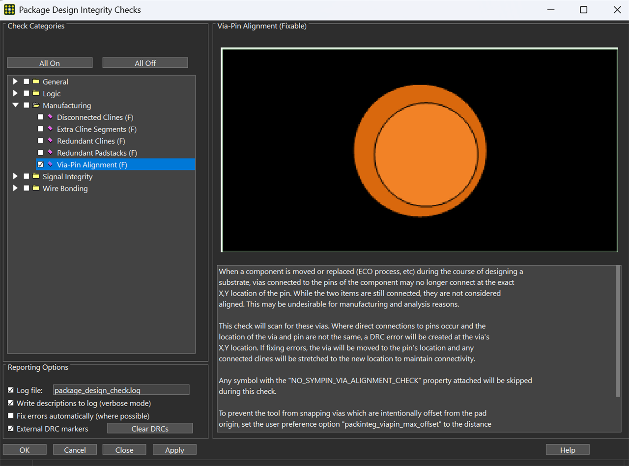

When a component is moved or replaced during an ECO, connected vias may no longer be perfectly aligned with the corresponding pin center. Although connectivity is maintained, this misalignment can lead to manufacturing and analysis concerns.
Allegro X/APD provides a built-in Via-Pin Alignment feature within Package Design Integrity to automatically detect and correct such issues.
1.  Open Tools > Package Design Integrity and navigate to the Manufacturing category. Select Via-Pin Alignment and click Apply to scan the design for misaligned vias.

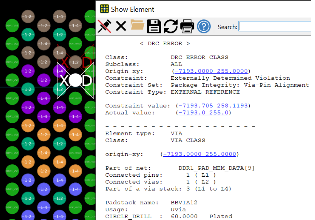

2. The check generates DRC markers at locations where the via center is not aligned with the pin center, helping you quickly identify affected areas.

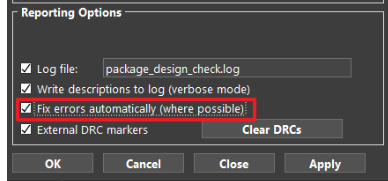

3. Enable Fix errors automatically and run the check again. The tool automatically moves the via to the pin center while maintaining connectivity by adjusting connected clines.
