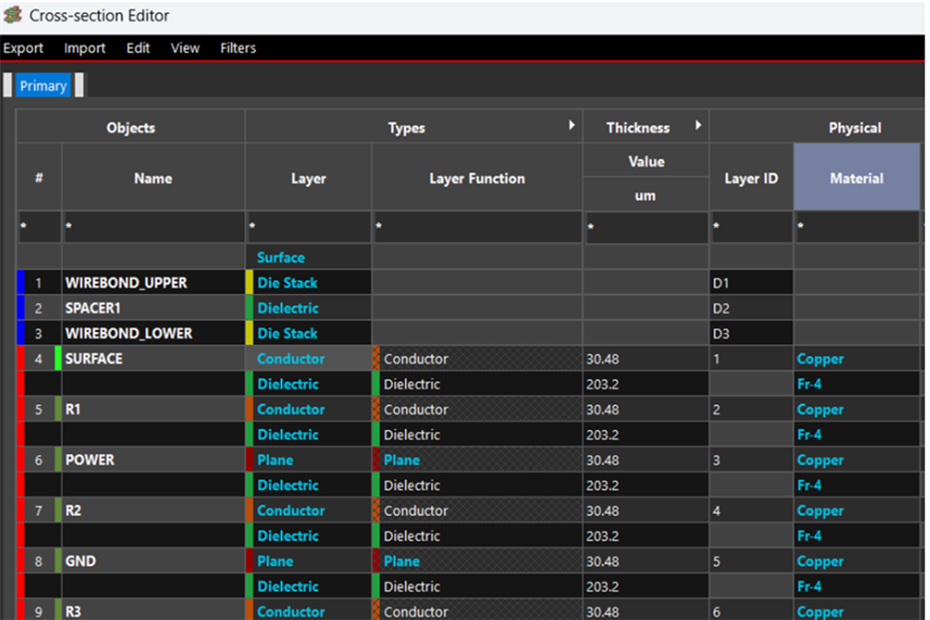

  • Open Setup > Cross-section and add a new layer below the required die layer.
  • Set the new layer's Function to Dielectric and assign a unique Layer ID (for example, D2).
  • Verify that the layer is visible in the Visibility pane.

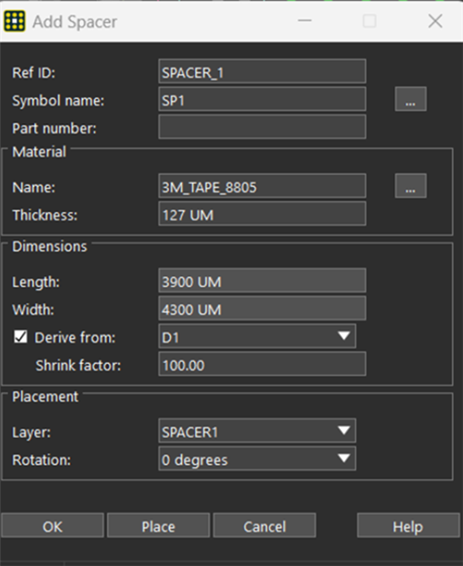

  • Select Add > Spacer and define the spacer properties, including material, thickness, and dimensions.
  • Specify the spacer size either manually or using the Shrink Factor option based on the die dimensions.

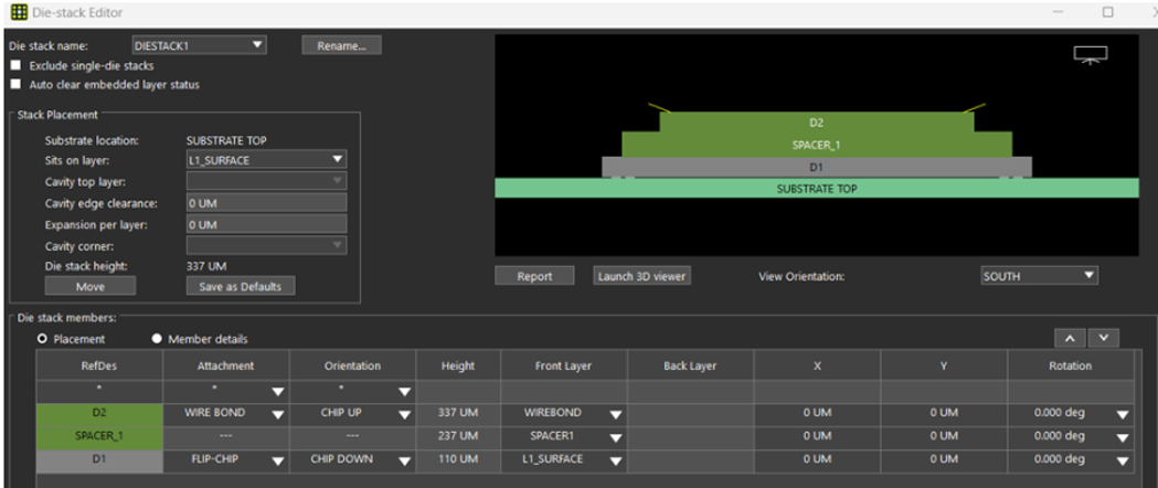

  • Place the spacer in the design and verify its position in Edit > Die Stack, making any alignment adjustments as needed.
