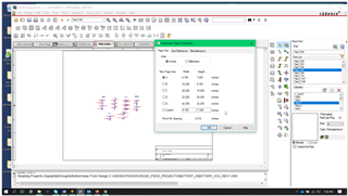

Hi, I have put together a three page schematic and the symbols are tiny when placed on the schematic sheet. I used basic symbols straight out of the transistor library and logic library. When I zoom out enough to see the whole sheet and title block, the components are so small that I cannot make them out.
I have the sheet sizes all set for size A, but that doesn't make a difference.
The title block appears to be the correct size for the sheet size  I am using. I tried closing and then reopemning the project, hoping that would set everything correctly, but nothing changed.

  • Nikom74
    0 Nikom74 over 6 years ago in reply to Araugel
    Hi, thanks for the suggestion. I tried that and it did not correct the problem. One clue I did see though was the Pin to Pin spacing in the Schematic Page properties is off by an order of magnitude.
  • Nikom74
    0 Nikom74 over 6 years ago in reply to Nikom74
    I attached a screenshot

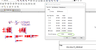

  • Araugel
    0 Araugel over 6 years ago in reply to Nikom74
    can you share the screenshots of schematic page with , Schematic page properties>millimeters>A3 selected
  • Nikom74
    Here you go, thanks
