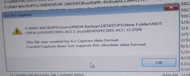

Hai there,
when I was trying open .dsn file in OrCAD v16.6 .
I getting the error like "this file was created by capture data format. current capture does not support this obsolete data format"
can anyone help me out from this how to open the files.. I'm attached the photo below please check that out
                                 THANKING YOU
  • oldmouldy
    0 oldmouldy over 5 years ago
    The 6.x OrCAD products were available for a very short period of time and upgrades to the 7.x tools were readily available (at the time, which would have been around 1995 or 1996), so a relatively small volume of 6.x data still exists. If you don't have access to a 7.x installation to update the 6.x files, which might well be the case since the supported Windows Environments are also a long way from being supported, you could send the data to Cadence Support, or to a Cadence Channel Partner, and they should be able to get the data converted to a format compatible with current versions.
