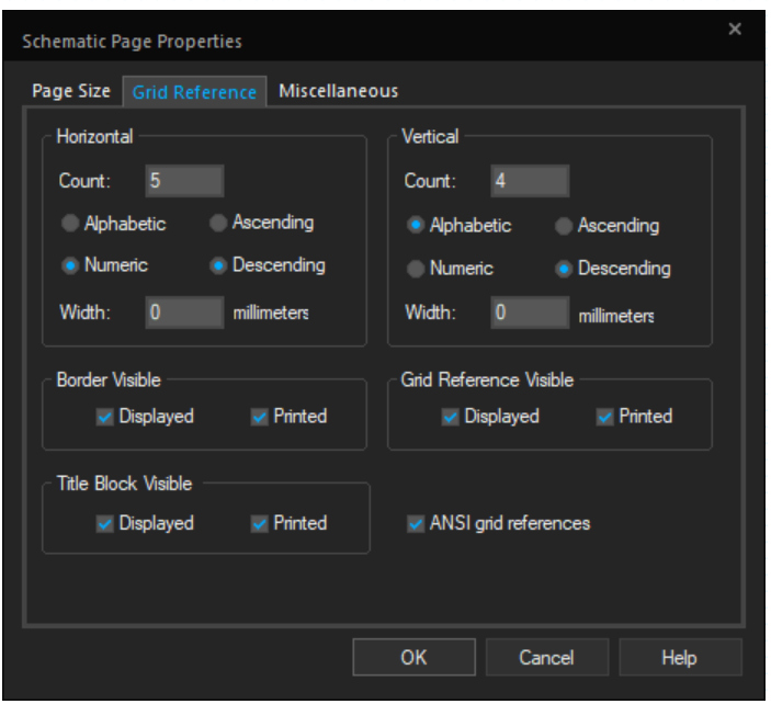

I have the Grid Reference width set as 2.54mm vertically and horizontally in the Design Template.
However when I add a new page the width is being reset to zero, as shown in Schematic Page Properties. Why doesn't it follow the 2.54mm width I've configured?
This is using Allegro Design Entry CIS v22.1 S0008

    For existing design, there does not seem to be any way from GUI. Rather, you can change it manually one by one for each page from 'Schematic page properties'.

    Try to create new design and see what do you see in schematic page properties. Design template settings get implemented for new designs.

    Yes, I can see that the schematic page properties are correct for a brand new design.
    Is there any way to change the design-level setting for an existing design?
