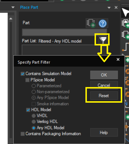

Hi everyone,
if i search any part after that filtered. How to remove this ? or how to reset this ?
I am not able to remove.. everyone time i need to close the Design capture CIS. again I need to open and search
  • Akshay khosla
    +1 Akshay khosla over 1 year ago
    Hi Kabalee,
    Please click on the filter icon as shown below and select Reset option then click OK.
    It will reset the filter. I can see this option in 23.1 release. Please let me know the tool version you are working on if this option is not present at your end.

  • kabalee
    0 kabalee over 1 year ago in reply to Akshay khosla
    Hi yes it is working but it is working if I  enter * after that enter .. with out reset it is working.. thanks
