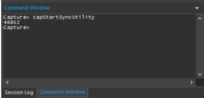

    In OrCAD X Capture, the background data sync utility keeps the data in sync between the local disk and the cloud. This background utility is needed to sync the files from your cloud account to your system. If this utility terminates, you will see a message for the same.
    To restart the sync utility again, type the following command in Command Window( You can enable command window in OrCAD X Capture by View > Command Window)
    Let me know how it goes for you after running this command at your end?

  • Jeet
    0 Jeet over 1 year ago in reply to cstocci52
    Navigate to Options> Extended Preferences> Cloud and disable the option 'Connect To Cloud On Application Launch'. When this option is disabled, this will prevent the Cloud login window from appearing when you don't want to use the Cloud functionality and want to use the normal OrCAD Capture features only without being prompted to log in to the Cloud.
    This feature is added in SPB 24.1 ISR 3.
