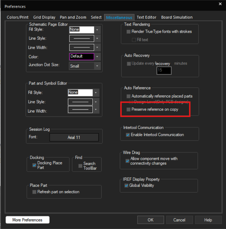

I copied and pasted a part with a ref des u1 but the new part has same ref des.How to avoid this
  • AyushD
    AyushD over 1 year ago +2 verified
    Go to Options -> Preferences -> Miscellaneous tab and disable "Preserve Reference on Copy" option under Auto Reference section.
  • AyushD
    +1 AyushD over 1 year ago
