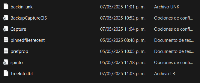

 capture cis 24.2 crashes uppon creating new project/design, I able to open demo projcets but it crashes uppon clicking on the "ok" button when creating a new project, and im not given any error messages

  • LR202504305130
    0 LR202504305130 over 1 year ago in reply to Akshay khosla
    I tried the proces you made, but when i got at the path where the "capture.ini"  file is suppposed to be,  it wasnt there
    these are the only files at the specified path

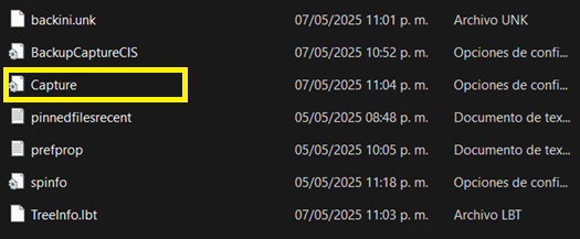

  • Akshay khosla
    0 Akshay khosla over 1 year ago in reply to LR202504305130
    Below highlighted file is Capture.ini
  • Akshay khosla
