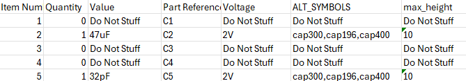

While generating Variant BOM in CIS, usually the DNP and non-DNP components are clubbed like below
Do we have any option to separate the DNP and non-DNP components in the excel report

    Hi Siri,
    You can separate the DNP and non-DNP components in the excel by sorting the Value property field as shown below
    Result:
    You can also do filter operation (in Sort/Filter menu) to separate DNI and non-DNI components, if Do not Stuff option is selected, it will only display non-DNI components.
