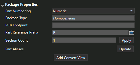

    Have a look at convert view (when defining your lib part), some say it can help although I admit I didn't use it.
