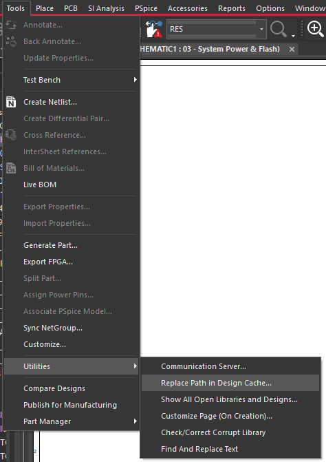

I copied a project folder from somebody who made the project: schematics and PCB by mixing our "shared library" in the network and their local folders, such as download folder. Part Manager shows errors (exact word "Approved: Not Found") because parts that are pointing at their local directories can not be reached from my PC. Components with those error status can't not be imported to my PCB. I could copy the .OLB files from them and place them somewhere in the network. The question is how to change the pointer to other folders?

    Option 1: If there aren't many components in the cache, you could do a manual cache replace: Option 2: If applicable, you can replace the lib path as shown below: Option 3: a bit tricky and I am not…
    Option 3: a bit tricky and I am not sure this solves your problem, edit the Capture.ini file, located in your work folder (cdssetup is located where your pcvenv is also located)
    allegroWork\cdssetup\OrCAD_Capture\23.1.0
    places to look at:
    [Part Library Directories]
    dir0=Q:\MYLIBRARY\ORCADCIS\SYMBOLS\
    [Part Selector Configured Libraries]
    Number of Configured Libraries=2
    Library0=Q:\MYLIBRARY\ORCADCIS\SYMBOLS\ADK_TEST.OLB
    Library1=C:\CADENCE\SPB_23.1\TOOLS\CAPTURE\LIBRARY\TRANSISTOR.OLB
    [Allegro Footprints]
    Dir0=Q:\MYLIBRARY\Data\...
    Dir1=Q:\MYLIBRARY\Data\...
    Dir2=Q:\MYLIBRARY\Data\...
    Dir3=Q:\MYLIBRARY\Data\...

    Thank you both. I am somewhat at the right direction now. The TCL script is the highlight, but without the guide from andakConsultingLtd and this post: https://community.cadence.com/cadence_technology_forums/pcb-design/f/pcb-design/33384/extract-and-use-local-library-from-dsn-and-brd-in-orcad-standard-16-6, it would not be possible to solve this issue.
