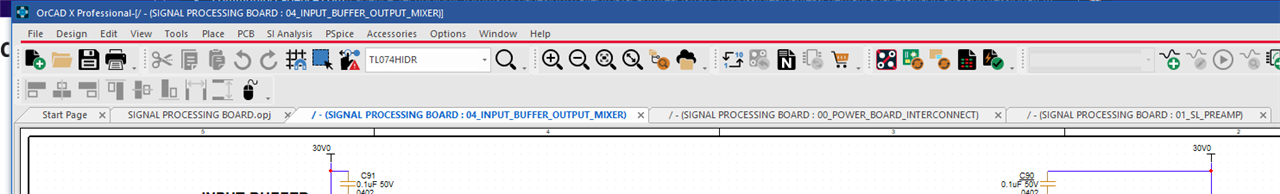

For years, using OrCAD work-supplied software I was to be able to tile pages within a schematic in the workspace, even from different designs, so that could do a side by side comparison. For instance, I might have page A which has control switches and a connector, and page B which has the mating connector and the devices which are connected to the connector, so that signals may be easily traced.
However, in my self-owned copy of OrCAD X (and back to 17.2) the three small buttons in upper RH corner of the page (minimize, maximize, close:  ) which would allow you to tile the pages no longer exist, only have a tab for each page which allows only a single page to be viewed at one time, cannot open two or more simultaneously.
Is there some way to enable this capability in X? It would make it much easier to look at two different schematic pages to trace signal flows between them.

    Yes that's possible here in Capture too. You can drag any schematic page and it will become floating with minimize and maximize button.

    Are you referring to make two schematic pages active at once so you can perform designing when the schematic pages are in floating state ?
    Which version of OrCAD X Capture you are using?

    Hi, yes. Corporate OrCAD software at my previous employer allowed multiple pages to "float" within the workspace. Each schematic page had the minimize/maximize/close buttons on it.
    This is my current self-owned version:

    Not in my case. NONE of the schematic pages has minimize or maximize buttons, only a close button.
    Is there a switch or setting that needs to be changed to enable all three buttons per page?
