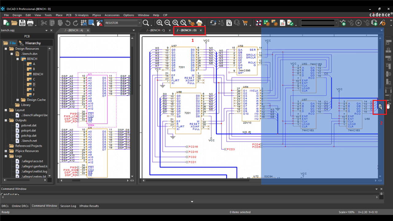

I saw another post, but the question was never answered. Just upgraded to Ocad X 24 from Orcad 16. I want to tile the schematic capture windows to work on multiple pages at one time. This used to be straightforward with the Window "Tile Horizontally" and "Tile Vertically" and "Cascade" menu options. Where are the commands in Orcad X?

    Hi DH202507237422 ,
    Yes, you can tile schematic pages in OrCAD X.
    To tile vertically, click and hold the schematic page tab, then drag it to the right edge of the schematic workspace until the vertical docking guide appears. Release the tab to dock it. For horizontal tiling, drag the tab to the bottom edge instead.
    Hope this helps!

    Thanks, that worked. What happens when more than two windows are open. Are these motions equivalent to "Tile Horizontally" and "Tile Vertically"?
