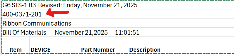

I'm trying to figure out where the BOM tool gets the info to fill in the field by the red arrow. This text doesn't appear anywhere in my schematic, it isn't in my preferences, and it isn't in the .opj file. Does anyone know where Capture is looking to fill in this field?

    oldmouldy 11 months ago +1 suggested
    Most likely, Options>Design Template ==>> Title in Title Block (Or another Title Block Property)
