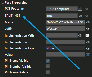

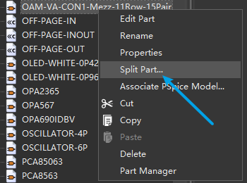

When I was editing the library file and performed the "Split Part" operation on an existing component ( it is OK in CIS 24.1 and contains "SPLIT_INST = TRUE" parameter ), A dialog box stating "Operation attempted is not supported" will pop up.Pressing "OK" will cause the pop-up to repeat three times.Has any of you encountered this problem and know how to solve it? Thanks a lot~

    Hi CNZJCHB ,
    Thank you for reporting this issue. It has already been logged and reported to the development team for further investigation and resolution.
    This behavior is specific to language environments, when the software is opened after deselecting ‘Use Local Language, in Options > Extended Preferences > General, it works correctly.

    This issue occurs exclusively on systems running Japanese or Chinese versions.
    The root cause is the absence of the `orSplitPart_res64.dll` localization resource file.
    Hotfix 030 has resolved this specific problem.
    However, a new issue has emerged: it is currently impossible to manually configure the language setting. The application now defaults to reading the system's native language mode, and attempting to set the interface to English has no effect.
    The only current solution for setting the Split Part interface to English is to rename the "orResources" folder located at `SPB_25.1\tools\orResources` to any other filename, thereby preventing the system from detecting the localization files.
