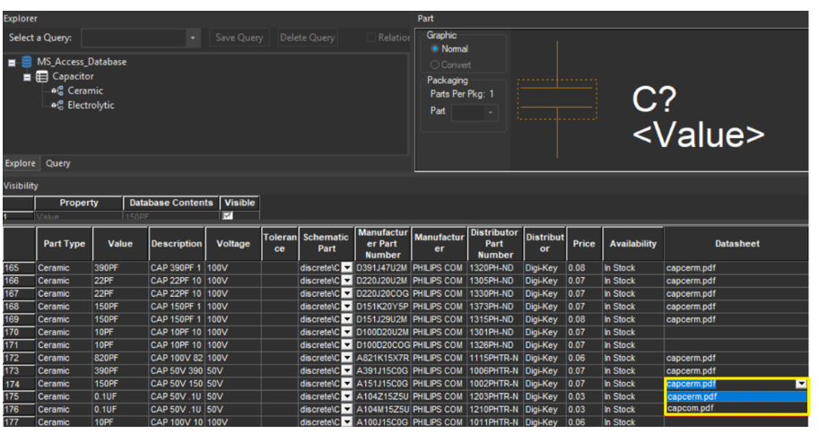

    SPB 17.4 onwards, any CIS field can be made multivalued with the help of the following Tcl command: SetCISMultiValuedField "FieldName" In the Command window, type the following commands: SetCISMultiValuedField…
  • Jeet
    0 Jeet 9 months ago

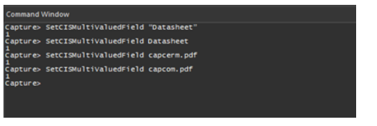

    SetCISMultiValuedField Datasheet
    SetCISMultiValuedField prop1
    SetCISMultiValuedField prop2
    Here, prop1 and prop2 are referring to the different values of the Datasheet property.
    Now, open CIS Explorer and the values will be seen as a drop-down list in CIS Explorer.
    You can read in detail on Cadence ASK Portal regarding you can make a filed to have multiple values in CIS Explorer.
    Article (20124578) Title: How can I make a field to have multiple values in CIS Explorer?
    URL: https://support.cadence.com/apex/ArticleAttachmentPortal?id=a1Od0000000sbkbEAA
    Let me know how it goes for you.

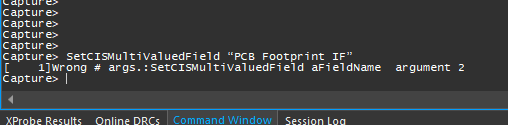

    Initially, the command worked correctly in my environment (SPB 25.1-2025-S010 with CIS Professional), and I was able to make a custom field behave as multi-valued in CIS Explorer.
    However, after updating Capture to SPB 25.1-2025-S020, the command is no longer recognised. When I try to execute:
    SetCISMultiValuedField "PCB Footprint IF"
    I now get the following error in the Command Window:
    Additional details:
    • Version: SPB 25.1-2025-S020
    • License: OrCAD Capture with CIS Professional
    • The command was entered in the Capture Command Window (Tcl console)
    Any clarification on how and when SetCISMultiValuedField is registered in the Tcl interpreter would be greatly appreciated.
