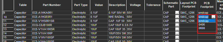

is it still a commonly used practice to declare a list of footprints in the "PCB Footprint" property of the OrCAD Symbol, especially if you are using a CIS database?
or is it advisable that the ALT_SYMBOLS property is used for Allegro?
The benefit of using the "PCB Footprint" property would be, that the Schematic Engineer in OrCAD could directly set the Footprint for the Layout Engineer. But as far as i understand, Allegro is only using the ALT_SYMBOLS property (or FPList as legacy) to allow a Layout Engineer to select the Footprint. if ALT_SYMBOLS is not provided, then there is only the single "PCB Footprint" value available (which is annotated through the netlist) the Schematic Engineer selects.
What is current best practices?

    Yes ALT_SYMBOL is the ideal way. However, if you want multiple field values to be displayed for PCB Footprints and want schematic designer to choose one out of many from CIS Explorer while selecting the part and want it to show drop down for PCB Footprint value with multiple values, then this can be achieved by defining multiple values using delimiter in Database only.
    Ex:
    In database, using comm as delimiter, values for PCB Footprint can be defined as :
    You can refer following article link from ASK Portal which are relevant for your query:

    Hi Pat, best practice is what basically works best for your design flow & there can be some variables with that.
    From the perspective of Alt_Symbols, when you package your design & generate a netlist, the primary PCB footprint is used. In the PCB editor when placing symbols if alt_symbols are defined it is possible to use those instead of the primary symbol. A good case for this would be something like a typical SMD resistor that has as it's base regular rectangular pads, but the alt symbol may have rounded pads instead so as to aid in manufacturing.
    In the CIS database what we do is have the first symbol defined in the Alt_Symbols field be the same as the primary PCB footprint name. The advantage here is when you look at the table you see consistency for both primary PCB footprint and also the alt symbol. Certainly you could have other symbols defined in the Alt_Symbols field too.
    Best practice IMHO is to have the primary symbol that is known good to be the default. Ideally when an engineer is designing a schematic you would not want them changing the PCB footprint on the fly !.
