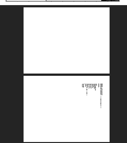

Hello everyone,
I’m currently using OrCAD X Capture 25.1, and I’m running into an issue when exporting a variant schematic to PDF. Every time I generate a PDF from a variant view, the output includes two extra pages, and one of those pages contains an error message that looks like below.
The actual error is captured as shown:
" ERROR: syntaxerror
OFFENDING COMMAND: ----nostringval----
STACK:
/JS
/JavaScript
/Subtype
-mark-
/Action
[0 0 0 ]
/Border
[0 1 0 ]
/Color
[748 61 604 1196 ]
/Rect
1/
SrcPg
-mark"
This only happens in variant as exporting the main schematic works normally with no extra pages or errors.
Has anyone seen this behavior before or know what might be causing it?
Thanks in advance!

    This issue is reported in our Cadence Database via a CCR. Also, which hotfix of Version 25.1 you are using ? ( You can check hotfix by Help > About after invoking OrCAD Capture)

    The problem is one of the TCL scripts. Solution: Copy over capPdfUtil.tcl from working version of orcad/allegro (I used base version of 25.1 e.g. c:\Cadence\SPB_25.1\tools\capture\tclscripts\capPDFExport…

    Hi, same problem for me too. I was using 24.1 and it was working fine. I believe there is something wrong with 25.1 as soon as it releases. Probably have to wait for new update

    Got the same on 24.1s008.
    Our support says it is fixed in upcoming update.
    I also heard this affects 23.1 too

    Did you try ensuring that there are NO SPACES in the entire directory path of the OrCAD project and PDF file location? Ghostscript is known to puke on directory spaces for some stupid reason. Not sure if this is the same issue as yours.
