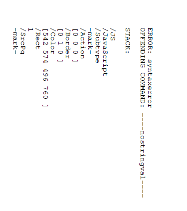

Plus i get 2 extra pages at the end of PDF every time i save it as PDF. And the last page shows this error message:
This behavior is not seen when i don't use View> Variant View Mode and display the pdf as is.

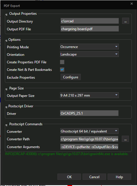

This is the settings i have in Export Window:
I have already tried changing the Driver name from OrCADPS_25.1 to 24.1/17.4 etc.
Also downloaded the latest version of Ghostscript(10.07.0).
