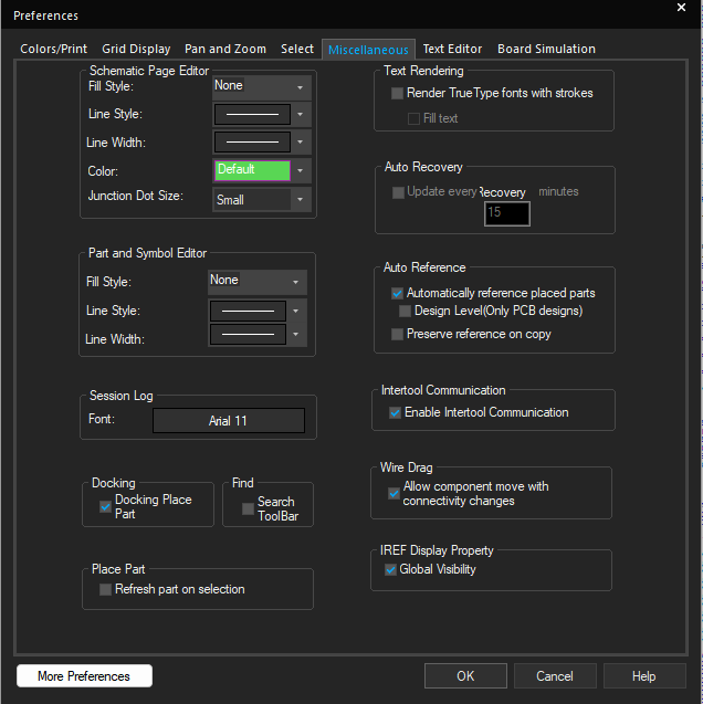

Issue with auto RefDes assignment in a hierarchical design.
OT202512144850
OT202512144850 7 months ago
Hi Team,
I'm designing a simple hierarchical design with 6 schematics inside of it, issue is that when i'm copy pasting any component inside the schematic, it is taking already assigned reference designator to it, this is found when i did netlist generation.
I have already enabled Automatically reference placed parts. Please help me to solve this issue.
  • oldmouldy
    oldmouldy 7 months ago +1 verified
    You need to also enable the "Design level" option for Auto Reference. This will look at the entire design before assigning a Reference. You can also use Tools>Annotate with "Unconditional" enabled to re…
