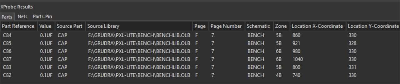

OrCAD X Capture CIS introduces the XProbe Results window to improve cross-probing usability.
When performing cross-probing between schematic and layout, instead of opening multiple schematic pages, the results are now consolidated into a dedicated XProbe Results window. This allows you to view, track, and manage all probed objects (components, nets, pins) in one place, reducing design clutter.
  • Open schematic in OrCAD X Capture CIS and board in Allegro X PCB Editor
  • Ensure designs are synchronized
  • Cross-probe any component/net/pin from schematic or layout
  • View results in the XProbe Results window
This makes cross-probing between Capture CIS and Allegro PCB Editor much more efficient and controlled.
