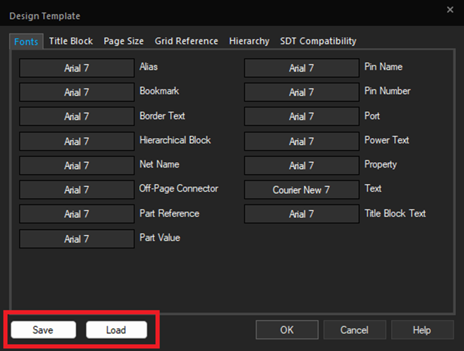

Starting with version 25.1, you can save and reuse Design Template settings to maintain consistency across projects. Design Template allows you to define default settings for new schematic designs, including fonts for various schematic objects, title block information, page size, grid references, and more.
To save and reuse Design Template settings, follow the given steps-
  • Navigate to Options > Design Template.
  • Customize the settings as required, including fonts, page size, title block, grid references, and other parameters.
  • Once customization is complete, click Save. A dialog box will prompt you to save the configuration as a .dtp file at your preferred location.
  • To apply the saved settings later, click Load in the Design Template dialog box and select the saved .dtp file from the desired location.
This feature allows designers to reuse design properties across new schematic designs, eliminating the need for redundant redefinition. Additionally, it enables seamless sharing of template files among teams and ensures consistent formatting in designs.

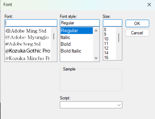

    Currently these are the available fonts in Place > Text as shown below-
    As per your suggestion Cadence should add a feature by which designers can add a Text apart from a single word correct or you are looking for a particular font named Andale Mono?

    It is the menu box itself I was referring to. When someone wants to place an arbitrary test and want to use eg. Courier, the text box in the add-text-canvas displays (Cadence) proportional text like tms roman, arial etc. This font cannot be changed. It is only possible to see the resulting alignment when having opted for courier only after the text has been placed in the schematic drawing. If the alignment (like having (white) spaces is wrong, the only way to correct it is to edit the text and in that edit box add or remove the (white) spaces.
