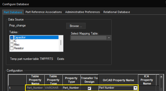

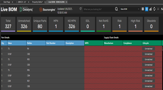

In OrCAD X Capture CIS, the Part Number column appears blank in Live BOM and Part Manager for existing components, even though the value exists in the database. The workspace is set to Local.
What is the most likely root cause?
A. The database is not connected properly, so Live BOM cannot fetch any properties for existing parts.
B. In the CIS configuration, the part_number field is mapped to a different OrCAD property name (for example, PART_NUMBER_NEW) than the property name used by the existing schematic parts.
C. Live BOM does not support displaying Part Number information when the workspace is set to Local.
D. The existing parts in the design must be re-placed from the CIS database before Live BOM can display the Part Number field.
Try the scenario and share observations.
