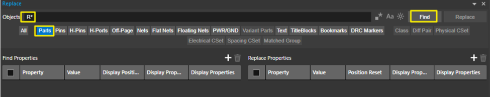

1. Open your schematic design in OrCAD X Capture CIS 25.1.
2. Choose Edit > Replace.
3. Select the required object type (Parts, Pins, H-Pins, and so on).
4.Enter a search pattern (for example, R* to find all resistors) and click Find.
The matching objects are displayed in the Find Results window, enabling quick navigation to the selected objects.

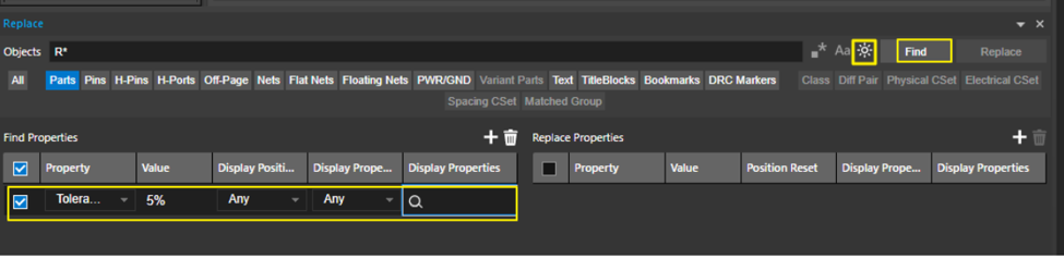

1. To further refine the search, click the + icon in the Find Properties section and add a new property criterion.
2. Select the desired property from the drop-down list. For example, choose Tolerance.
3. Specify the required property value, such as 5%.
4. Click Highlight and then select Find.

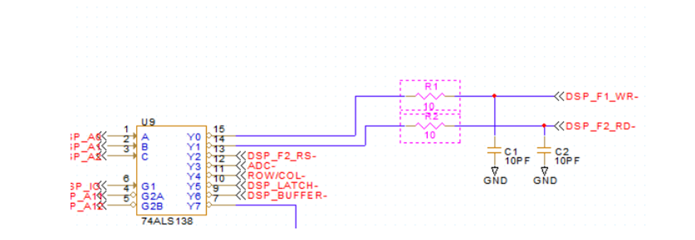

The search returns all resistors with a Tolerance value of 5%, and the corresponding symbols are highlighted directly in the schematic.
