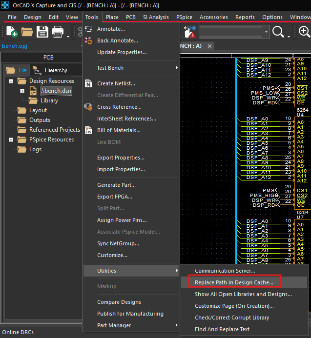

Hi all,
When sharing a design with another engineer, I understand that if the schematic libraries are located in a different location, the recipient can use Replace Cache from the Design Cache to synchronize the design with the new library location. This works well for a small number of parts, but on larger projects containing hundreds of components, updating the cache one part at a time can become very time-consuming.
Is there a method in OrCAD Capture to automatically update or refresh all cached parts in a design against the referenced libraries in a single operation?
Thanks!

    In Orcad Capture, Replace path in design cache utility can be used to replace design cache path. Please find following link of article which talks about the same: Article (20159217) Title: How to…
  • rg13
    +1 rg13 1 month ago
    Article (20159217) Title: How to use ‘Replace path in design cache’ option given in Allegro Design Entry CIS?
    URL: https://ask.cadence.com/ASK/article-viewer?id=a1Od0000000swShEAI&pageName=article-viewer
    See if it fulfills your purpose.
